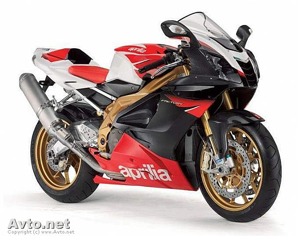

Kawl Objavljeno April 10, 2009 Deli Objavljeno April 10, 2009 Za factory mogoče pa res Da ga novš res kej srov!! :closedeyes: Povezava do komentarja Delite na drugih straneh More sharing options...
Jure Objavljeno April 10, 2009 Deli Objavljeno April 10, 2009 :wub: Povezava do komentarja Delite na drugih straneh More sharing options...
